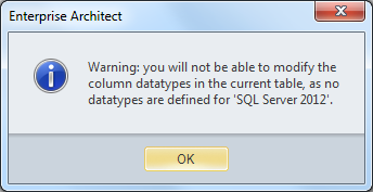

EA brings the powerful new database builder.
I create a new SQL Server 2012 data model
I create a table
But
What am I missing?

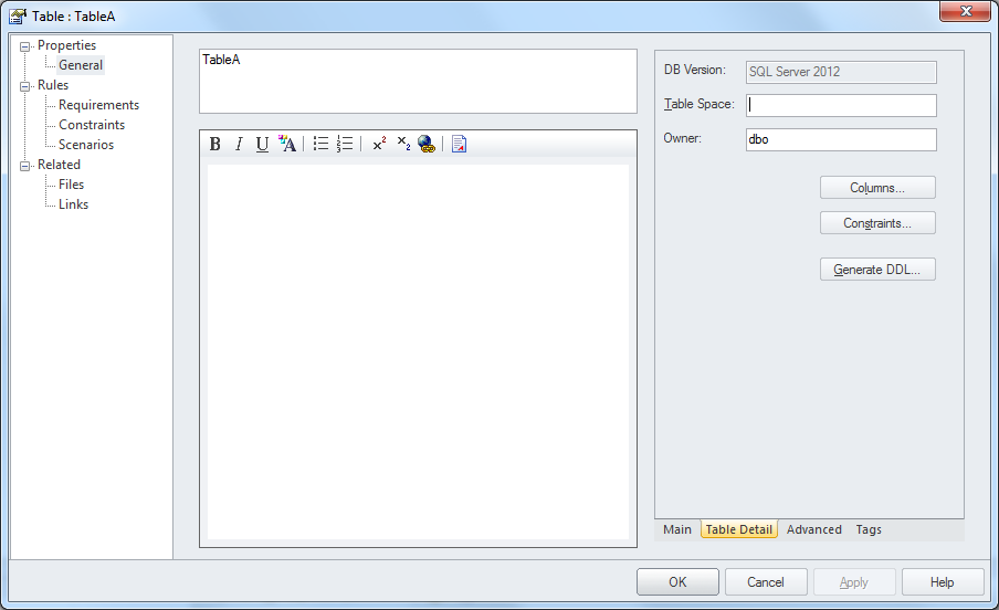

On a related note
Where does the DBVersion (shown above) come from,
and how do I change it (it is greyed out)?
Using EA15.2 (1555) on Windows 10 Enterprise/64 bit. Repositories in SQLServer2019.

They should be available with your version of EA, but Database datatypes are stored as reference data within the model.  If you are working with an old repository that was created before those types were introduced, then you will need to import them.
Easiest way to do this at the moment - Create a new local EAP project.  See: Project | Settings | Database Datatypes.  You should find the SQL Server 2012 datatypes.
Export them using: Project | Data Management | Export Reference Data > Model Data Types - Code and DDL.
Import into your repository.
