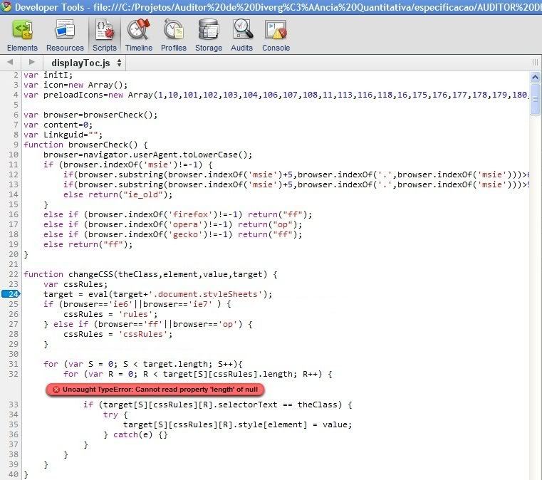

I debug the code in java script console own Chrome. There is an array that is checking the size of a null string. That is what is happening ....
Is there any estimate of when or how we can solve the problem?
