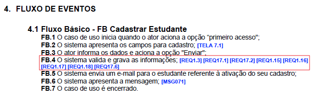

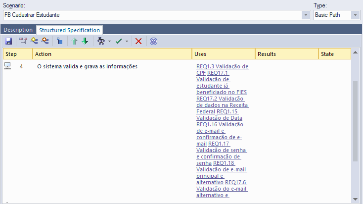

The use case model description that I use at work, has some peculiarities..
For instance, I did also, a great transformation of Scenario.Step.Uses field from this:
to this (after report generation):
This was made using JScript and the result was better than I expected.
« Last Edit: March 07, 2015, 01:13:48 pm by aelkz »
