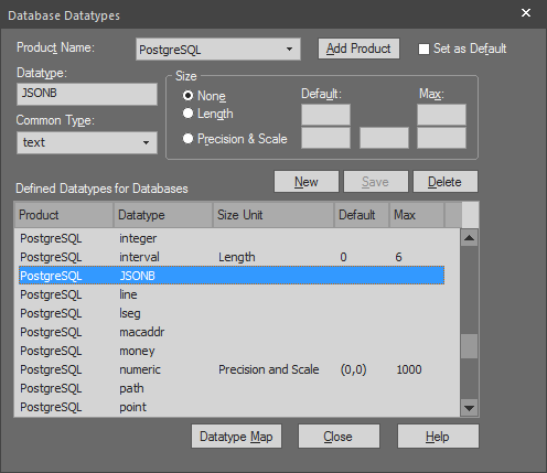

You can define and add a new datatype for Postgresql.
Navigate to Configure > Reference Data > Settings > Database Datatypes
Choose Postgresql and add a type for JSON or JSONB (like below).  Once added can be used in defining columns
For more details refer Sparx help
https://sparxsystems.com/enterprise_architect_user_guide/14.0/model_domains/dbmsdatatypes.html
