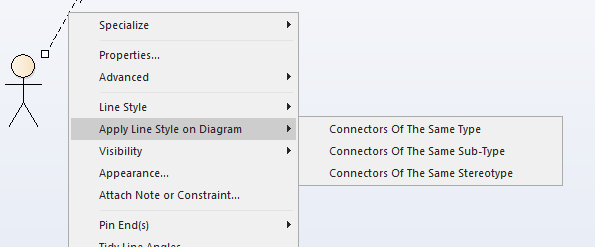

Is it possible to change the line style for all relationships on a diagram at the same time. I can see how to do one at a time, via the context menu, but can't see how select more than one relationship to apply the change to more than one.

Try Apply Line Styles on Diagram option in connector context
or you can write your own script for defining the Line style.
For customized script you can refer here

« Reply #2 on: February 01, 2019, 10:28:47 pm »
That's great, thanks.
I've been able to use the script to do it. Looking at your menu options it very much looks like you have a more up to date version of EA than us. We're still stuck on 13 at the moment.
