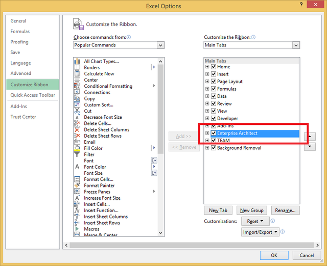

Re: MDG Integration for Office 64bit
« Reply #2 on: April 18, 2019, 11:51:01 pm »
Hi Ruper
MDG Integration for Microsoft Office 32 Bit
If you have 32 Microsoft office applications ( Word , Excel and Power point ) then please install the 32 bit version of MDG Integration
MDG Integration for Microsoft Office 64 Bit
If you have 64 Microsoft office applications ( Word , Excel and Power point ) then please install the 64 bit version of MDG Integration

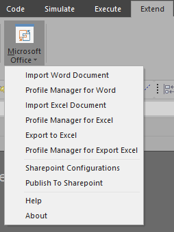

1. In EA -> Extend Tab -> Microsoft Office
2. In Word , Excel and PowerPoint ( there will be an tab named as Enterprise Architect as shown below )
2.1 If in office applications if the tab is not enabled by default
      Try enabling it manually
      File -> Options -> Customize Ribbon ( Enable Enterprise Architect Ribbon high lightened below )
« Reply #3 on: April 23, 2019, 10:24:20 am »
Yes, that's done it.
Thanks Arshad
