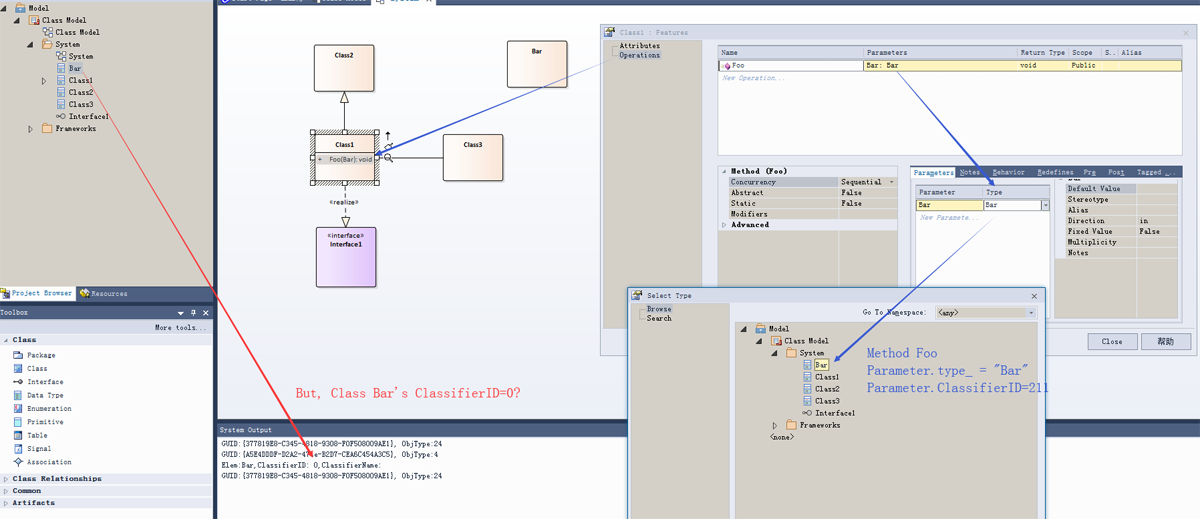

for example:
But the Parameter.ClassifierID (value=211) completely different from Class Bar's ClassifierID (value = 0)
How to deal with it?

It references the class ObjectID

oh..........got it.  8)
the value of Parameter.ClassifierID  is exactly the ID of the Element (ElementID).
