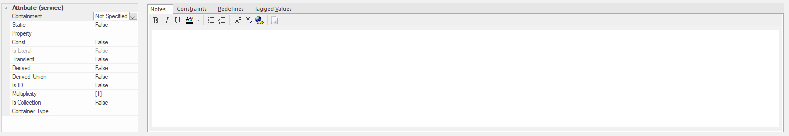

Hello. I'm trying to export classes' information through a JavaScript script that I've implemented inside EA. I would like to define new properties for the attributes, like: is this attribute a list? Could it be optional?
For this reason, I was thinking to add this properties like the ones already defined by EA (image below). Is it possible to add new properties?

No, those can't be extended. Instead use tagged values (right tab in your pict; the EA name for stereotype properties) for that purpose.

Further to what qwerty has said, in EA 15 your profile tagged values will show in the same list as the built-in attribute properties. So it's closer to what you were initially asking for.
