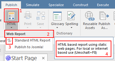

Hello,
is it possible to customize an addin for EA 15 such that it uses...
  • a main icon,
  • group menu items,
  • menu item icons,
  • or a custom tooltip (other than the menu item's text)?
Thank you in advance!

No, you can only set the menu/submenu's name
and whether or not these need to be enabled/disabled and whether or not it is checked.
More info here: https://www.sparxsystems.com/enterprise_architect_user_guide/15.0/automation/definingmenuitems.html

That's a pity - thank you for clarifying.  ;D
