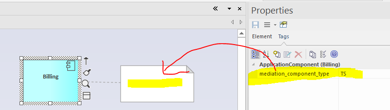

I am not sure if I understand you correctly. Here is the use case:
I would like to see in the note, the TAG Value .

You need to open the context menu of the note link.

« Reply #4 on: March 10, 2020, 01:42:13 am »
... Link this Note to an Element feature -- Single Tag and Notes    or   Attribute.

« Reply #8 on: March 10, 2020, 11:45:54 pm »
Ok, thanks. I found it now. For tag values it works nicely. I can display one or more Tags in the note.
For Attributes I found only options to show one specific atribute and not more.

« Reply #9 on: March 11, 2020, 12:37:50 am »
Attributes can be shown in the element compartment itself. Use Features/Visbility. You can also show (all) tags here and with Custom you can show individual attributes.
