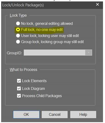

Is there any API/Method in the object Model which I can use to apply full lock? Where I can only see the ApplyUserLock() method, but I would like to perform the full lock and not just user lock. Can anyone suggest me the way to solve this problem?

What is your definition of a full lock? ApplyUserLockRecursive?

Hi Qwerty
Thanks for your reply.
I would like to access the full lock marked here

« Reply #3 on: May 12, 2020, 09:23:13 pm »
Probably Package.SetReadOnly (boolean ReadOnly, boolean IncludeSubPkgs)
But I've never used that function, so I don't know what it'll do.
Re: How can i perform full lock through EA Automation Interface?
« Reply #4 on: May 12, 2020, 10:18:35 pm »
I would just use ApplyUserLockRecursive with the admin as user. That offers all the options from the dialog and since there is only one admin actually nobody else can edit afterwards. SetReadOnly is obviously something different. See the help.
P.S. Just tried that function. It shows a lock on each package and everything is r/o afterwards. Different to Apply User Lock, but maybe an alternative?
