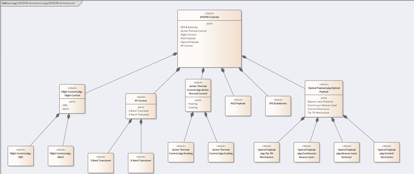

Firstly, the system I am looking to model (a small CubeSat satellite) would be made up of a simple architectural model that breaks the system into a few high level subsystem components (payload, power control unit, antennas, thermal control etc.) – first picture
<img src="https://i.ibb.co/7GkZ054/EA.png" alt="EA" border="0">

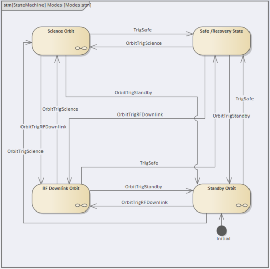

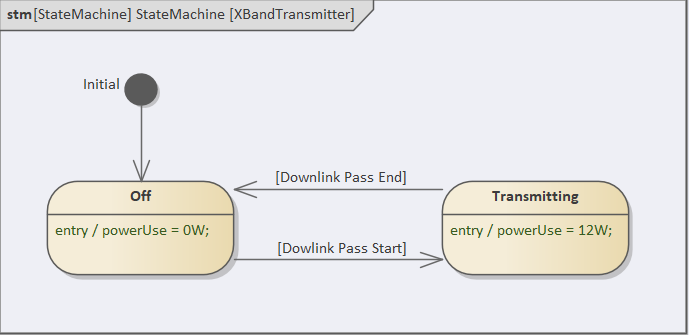

Secondly, the system can be in a variety of states to reflect the various operating phases of the satellite during nominal operations (carrying out scientific ops, communicating with ground station etc.). The various subsystems would then have their own individual states to reflect the different modes that they are placed in during the various phases of the mission (i.e. the antenna is only powered on during communications with the ground station) – second and third picture
<img src="https://i.ibb.co/hXjRXm4/Sat-Modes.png" alt="Sat-Modes" border="0">
<img src="https://i.ibb.co/m9WzvgN/XBand.png" alt="XBand" border="0">

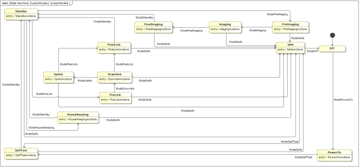

When previously attempting this modelling exercise in Cameo System Modeller, I achieved this from  a combination of Activity, StateMachine, BDD and IBD diagrams. The StateMachine was made from the various modes the satellite could be in, with transitions between each mode. The transitions were triggered by the reception of signals. When the overall satellite transitioned between high level modes, it would cause entryBehavior that then sent further signals to trigger the subsystems to change their respective modes – fourth picture
<img src="https://i.ibb.co/L8Rr8WT/Modes.png" alt="Modes" border="0">

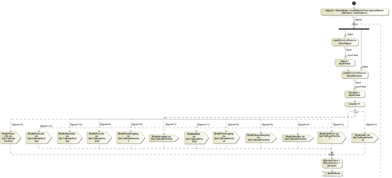

These signals were generated by an activity diagram that read in data from an external Excel file line by line – fifth picture
<img src="https://i.ibb.co/WNhQCrX/Excel-SIm.png" alt="Excel-SIm" border="0">

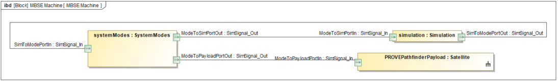

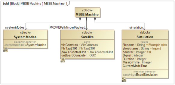

The overall model was contained in a high-level BDD to allow the necessary proxy ports to be created between the segments of the model to allow Value Properties and Signals to be carried between the various blocks using ports and IBDs – seventh and eighth picture
<img src="https://i.ibb.co/rt4GXpK/Overall.png" alt="Overall" border="0">
<img src="https://i.ibb.co/TWmzDBg/IBD.png" alt="IBD" border="0">
