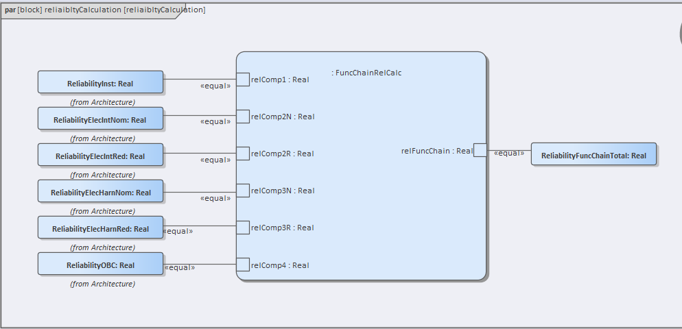

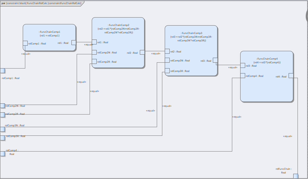

Thanks for the reply, I have experimented somewhat with OpenModelica and have got it to facilitate the roll-up functionality - albeit in a quite rudimentary form.
The main aspect I am trying to model is having a chain of system components (say an instrument that is connected to a control board by a series of interfaces and electrical connections as you can see in the picture), and having redundant aspects within the functional chain such that cross-strapping can be achieved.
<img src="https://i.ibb.co/6XkD83g/Architecture.png" alt="Architecture" border="0">
<img src="https://i.ibb.co/BBRy8Rv/Constraints.png" alt="Constraints" border="0">
Essentially, by adding in varying levels of cross-strapping (i.e. varying which components have redundancy), the overall reliably of the system would be effected.
However, the legwork taken to structure the Parametric diagrams and then relying on OpenModelica to carry out what is very basic addition and multiplication seems to be very high (see in the pictures). I am also completely stumped as to how I would implement the ability to adapt the architectural model of the system, and get that to relate to affecting parametric model and change the total reliability value produced as all the constraint equations are static, and I don’t see a way to allow them to adapt, say as more elements are added to the architectural model.
