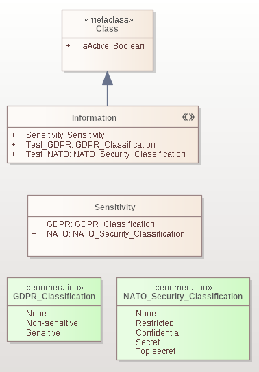

I'm trying to create a profile and have reached a bump.
I've created an Information stereotype extended from class metaclass.
Information stereotype has an attribute Sensitive of type class (ordinary class) which in turn contains 2 attributes of type enumeration (different enumerations).
Problem is that when loading the profile, Information stereotype does get the Sensitivity attribute shown, but the two enumerations do not have drop-down - They are just free text edit boxes.
I've added the same two enumerations directly to Information, and they have both drop-down selections.
How can structured tagged values containing enumerations retain their drop-down functionality?
I'm not to keen to create grouped tags, as Sensitivity is going to be used quite a few places.

That is probably not possible currently.
If you have that same combo in multiple stereotypes, you might want to consider making an abstract stereotype that contains these (grouped) tags, and let the other stereotypes inherit from that.
