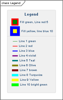

I have the following legend in a diagram.

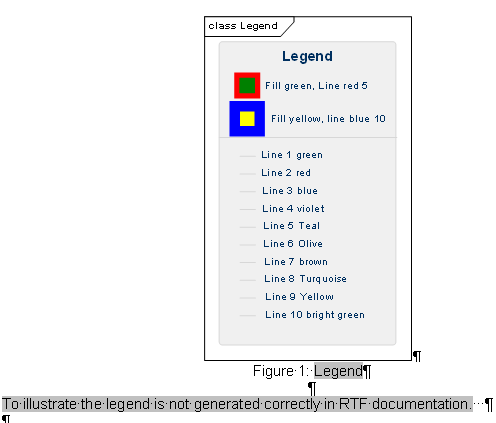

When I generate my document this is the legend that is displayed.
has anyone else observed this problem?
I believe this may also be an issue in recent earlier versions of EA?

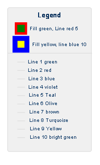

If you use Diagram | Copy Image you get this - also wrong

My immediate response is that it looks like metafiles are causing the problem, in that case try changing your options for GDI+ metafiles (Tools | Options | Diagram | Appearance) or setting your report to use bitmaps.

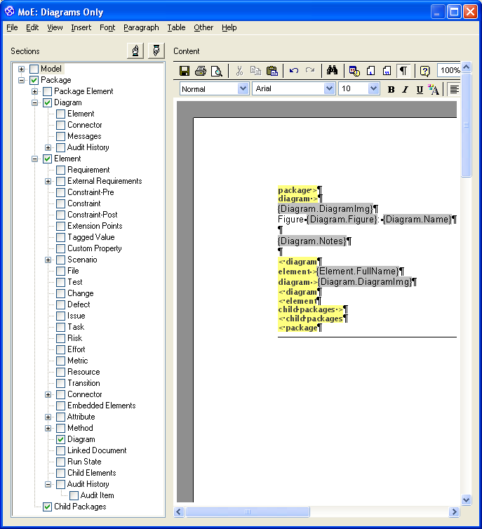

There is an option in the generator.  (Look at the advanced tab) Bearing in mind that it allows a temporary override of the options specified in the template itself.

Regarding the option to generate bitmaps, I'll try to explain it further.  All of the options of the advanced page of the RTF Generation dialog also exist as properties of each RTF template.  If you wish to change the default, you need to change the template.  I believe that all templates provided by Sparx Systems use metafile images as the default.
