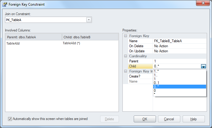

I have 2 tables, A and B. Table A has a primary key defined, lets call it PKa and table B has no primary key defined and a foreign key to table A, lets call it FKa. I have a foreign key constraint constrain between the 2 tables, lets call it FKa_b.
I cannot set the cardinality of FKa_b to 1..1/1..*, this is to signify that 1 and only 1 row in table A can have 1 or many rows in table B. Each time I try it EA changes it to 1..1/0...*. In fact, it does not even allow me to create a 1/1..* relationship but it has no problems with a 1/0..*.
What have I missed?
P.S.: I have moved this post from the general board. Currently running EA 12 build (1212) and the problem is still there.

I have not had a reply to this. This is a serious problem, so serious that I am starting to doubt EA's database modelling capabilities.
An Order can have 1 or more items in it, if it has no items there is no order. EA does let me create a relationship between an Order table and an Oder Line Item table with a cardinality of 1/1..*.

I can be ignorant and stupid but not that ignorant and stupid  ;). You can choose them but EA 12 (Build 1212) changes the selections as explained above.
Please read the thread. You can select them, the problem is that EA doesn't keep them.

Luck I might need because I have not found an answer yet and this is starting to look like an EA bug.
I have established that EA12 is actually changing by selections after I click Ok or Apply. So there must be some "EA logic" driving this.

Hi Modesto,
I think this issue was resolved in Build 1213. The release notes for 1213 contain an entry like:
Foreign Key dialog now saves child cardinality
Can you please confirm that this addresses your concern?
