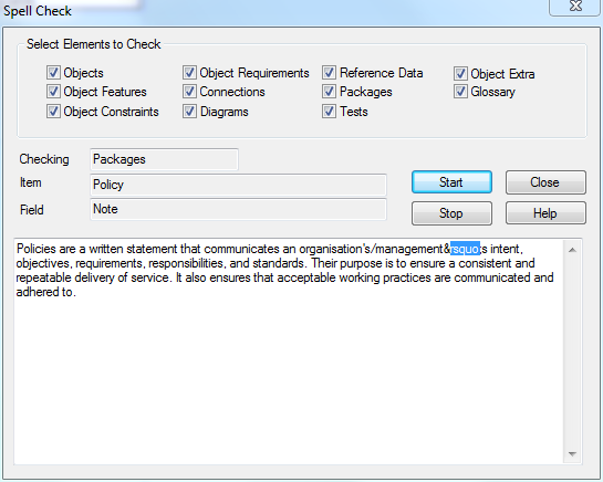

When running the spell checker it insists on tagging as errors all the html tags in notes. Actually the tags should be "invisible".
The spell check should igore the underlying formatting of notes fields.
Not fixed as of 9.2

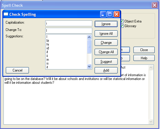

« Reply #2 on: May 28, 2010, 12:23:36 pm »
Each time EA find a spelling error it repositions the "Spell checking" dialogue box over the "Spell Check" dialogue box.
This hides the context of the actual misspelt word.
1) EA should not position the Spell checking" dialogue box over the "Spell check" dialogue box.
2) EA should preserve the last position of the "Spell checking" dialogue box.
Fixed by 9.2
« Last Edit: November 21, 2011, 12:48:01 pm by skiwi »

There's a topic I created for v8 (which I can't find) that bemoans the loss of the "options" for Spell checking.
While we're waiting Sparx to fix up the Spelling Options - you can change the checking of HTML tags via:
HKEY_CURRENT_USER\Software\Wintertree\SSCE\IgnoreHTMLMarkups
HTH,
