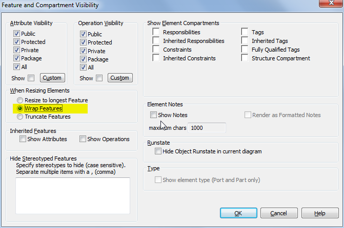

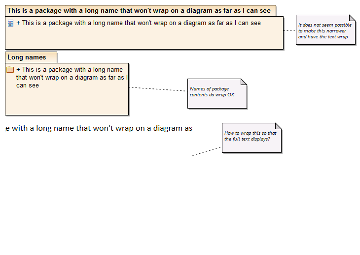

From the general to the specific.
Sometimes labels can be too long for the horizontal space available.
It should be possible to manually change the width of a label and have the text in it reflow to multiple lines
It's been in EA for years.
Ctrl+Shift+Y - set to wrap features.
We may be thinking of different things here, in the example below I have used ctrl-shift-y Feature and Compartment visibility to set the option "Wrap Features" for the three entities, viz
This helps with entities contained in a package, but not with the Package name itself, or a <chart>
