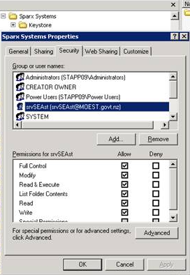

The permissions we gave to the service

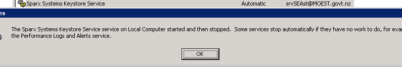

The service start message

The Sparx Systems Keystore Service service was successfully sent a start control.
Followed by
Event Type:     Information
Event Source:  Service Control Manager
Event Category:          None
Event ID:        7036
Date:               7/03/2011
Time:               10:41:28 a.m.
User:                N/A
Computer:       *******
Description:
The Sparx Systems Keystore Service service entered the stopped state.
Note how it terminates immediately without any message.

I wish I knew, the response I get is
As seen in your screenshots - your service account appears to have full permissions to the key store directory in the file system.  This would suggest that your problem is most likely with your Local Security Policy configuration.
