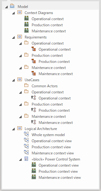

If I manage contexts, I will use package structures. The following is an example (skeleton).
  • First, I create context diagrams to define each context e.g., who are related to the system and what are outer systems.
  • Then, find Requirements in each context.
  • And I also find Usecases in each context.
  • I will not create context block like you. To describe structures for each context, I will create a BDD and a IBD for each context. In BDDs, Blocks are commonly used (i.e., copy some Blocks in a main BDD by Ctrl+C and paste them onto a context BDD by Ctrl+V). If I want to describe IBD for each context, I will create IBDs under the main Block (in above image, the Power Control System block)
To summarize, I will use diagrams to describe contexts but elements (in this example, Blocks and Actors) in diagrams are commonly used (except Properties in this case - Properties are instanced objects of Blocks).

When we create context diagram, there is no BDD, IBD or all other diagram. So we create elements directly. Actually, there is no definition of a context diagram in the SysML specification, but I usually use IBDs to describe contexts. You can see examples in the EAExample model and the SysML specification, the Annex D: Sample Problem.
I assume that IBDs in Context Diagrams show connections of our Power Control System with external systems, and IBDs under Power Control System show internal connections.
I use context diagrams to understand, clarify and share 'what we will create and what we will not (i.e. use existing other systems)'. So, I describe very rough information in the context diagrams. In detail, I need to describe in other diagrams at a later step.
For example, I use just a 'Command' in context diagram to describe communiation to other system by some Commands, but usually there are many kind of actual Commands. I will use other diagrams for detail (e.g. return ACK command (reply) when a system receive a START command), in a later step.
