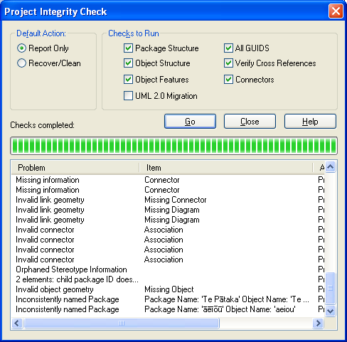

Unicode support in EA - causes project integrity c
« Reply #13 on: October 13, 2009, 10:05:56 am »
In some cases the use of Unicode causes the project integrity check to fail, see the (not attached - grrr) image below
