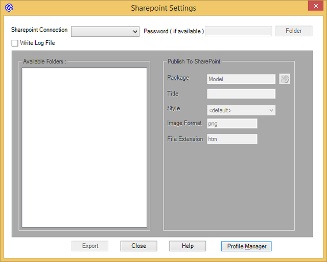

Hello!
I did some googling but mostly found questions regarding using SharePoint as repository which is not what I'm looking for.
I can't find out what the SharePoint integration is. There is Publish to SharePoint. Is this a HTML-export? Images? Should I use it on diagrams? Packages? Root nodes?
Also, I can't seem to be able to connect to our SharePoint URL. Do I have to log in as admin? What URL should I use? name.sharepoint.com? name.sharepoint.com/sub-page..?
Where can I find more information?
Thank you!
Robert

« Reply #4 on: April 08, 2019, 05:41:46 pm »
Hi Hurra
SharePoint Integration in MDG Integration for Microsoft Office is used to publish EA model contents as HTML contents directly into SharePoint.
  • Configure your share point credentials and connection strings under Profile Manager
  • Open Publish to SharePoint
  • Choose an added existing connection and enter the password if available
  • Choose a folder from Available Folders (displays all the available folders in the selected SharePoint connection)
  • Enter the publish settings
  • Select Export
For more details click the Help button.
You can find the user guide under
file:///C:/ProgramData/MDG%20Integration%20for%20Microsoft%20Office/Help%20Document/UserGuide/index.html#SPIntegration
(if MDG Integrtion for Microsoft Office was installed )
