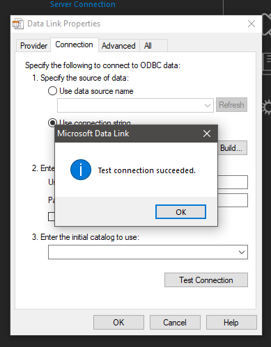

When program starts, I click on Server Connection, and the Data Link Properties window appear:
Then I select the Connection Tab, select the "Use Connection String" option and then I put the following string that I've calculated (user, server, pass are different of course).
Driver=MySQL ODBC 8.0 Unicode Driver;SERVER=my.server.ip;UID=myuser;PWD={my_password};DATABASE=enterprise_architect;PORT=3306;BIG_PACKETS=1;AUTO_RECONNECT=1
Then I click on Test Connection and the connection is tested.

I'm by no means a database expert. Every time I've ever used an ODBC connection through those dialogs I've pre-configured a data source using odbcad32 (from syswow64) and then selected "Use Data Source Name". This results in me seeing the first two dialogs, followed by the first dark one, which allows for EA specific settings including a locally assigned name.
It appears that EA is looking for a named data source. Are you able to configure your connection that way?

Yes, I've tried in your way and it works, thanks.
