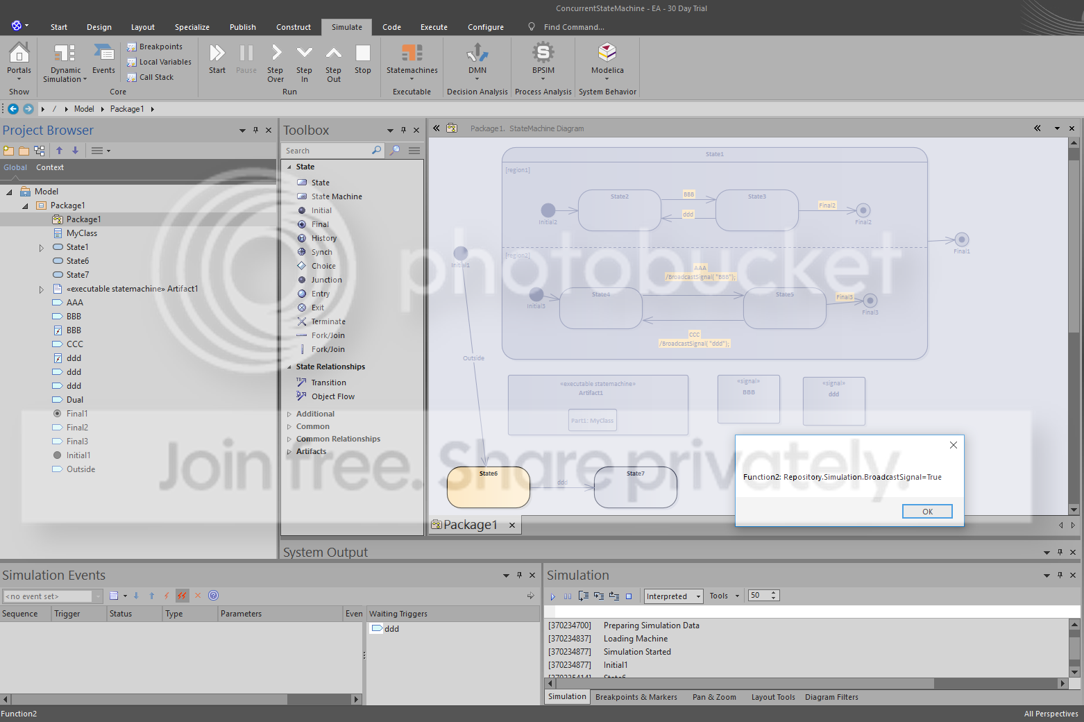

My goal is to interface from an external application to a running simulation in Enterprise Architect.
Right now I am calling bool Result = Repository.Simulation.BroadcastSignal("ddd", ""); from a self-made Add-in, hoping that it triggers a transition signal in the simulation. The code in C# returns true, but the simulation is not affected. What might be the problem?
See below for my code and a screenshot of my test-model.
private void Function2(EA.Repository Repository)
    if (Repository.Simulation.IsSimulatorRunning())
        MessageBox.Show("Function2: Repository.Simulation.BroadcastSignal=" + Result);
    else
        MessageBox.Show("Function2: Simulation=" + Repository);
