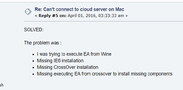

This issue has already been discussed here many times.
Please find the fix below and for more details refer the original topic
https://www.sparxsystems.com/forums/smf/index.php/topic,30465.msg222335.html#msg222335

thank you very much for the quick answer, I had already found this thread.
However, I could not do anything with the answer.
1) I was trying to execute EA from Wine -> What is the correct way to execute it ?
2) Missing IE6 installtion -> Is 'winetricks ie6' enough ?
3) Missing CrossOver installation -> This is commercial or? https://www.codeweavers.com/products/crossover-linux/
4) Missing executing EA from crossover to install missing components -> same as 3)
