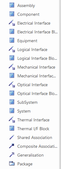

I am currently working to create an architectural model of a simple satellite. I am making use of a custom MDG-Technology perspective that defines specific satellite-related blocks (assemblies, components etc.) and interfaces (electrical, thermal, mechanical etc.) - see picture.

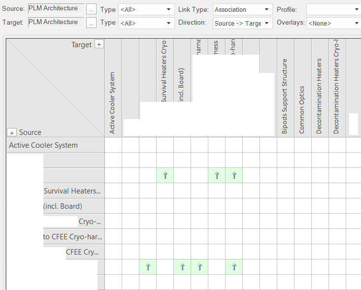

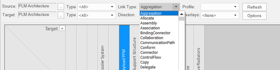

The main aim of this is to use the Relationship Matrix to track the various interfaces between the different satellite elements (i.e. electrical interfaces between specific subsystem components). Within the Relationship Matrix I understand there is the ability to track from a selection of multiple element and link types, and the option to "Change Perspective" - I assume to allow tracking of elements and interface types that are defined within a Custom MDG-Technology perspective.
However, after choosing my custom perspective from "User Perspective", there is no change in the selection of element or interface type that can be selected (see picture). Consequently, I cannot show the desired custom interfaces within the Relationship Matrix. The only interfaces of my model that I can see are the basic "Aggregation" relationships which just relate to how the model is constructed, which are not of any interest.

You can select "all perspectives" to show all possible relation types.
There is also an option to show any relation type in the matrix.

Unfortunately even when I choose to display all perspectives, the custom MDG interfaces still aren't displayed. Additionally, my software appears to have no option for displaying all link types - only a single one at a time (unlike with elements where all types can be displayed).
However, I might have noticed the issue (or at least one of them). The different custom relationships are stereotypes of the Association relation type - would this mean that I could only see if an Association relation type is present, and not the individual custom relationships? (see picture below)
