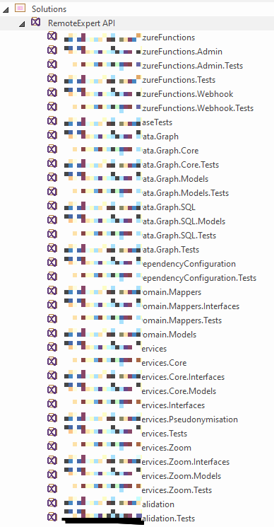

As Michael pointed out, in the Compare Edition clearly states that VS Integration is not available below Unified. BTW, I can confirm that it doesn't work: it only retrieves the solution's tree but no .cs files at all. I end up with this tree in EA:
What am I missing here?
~Pino

I can confirm that the solution import absolutely Does Not Work as advertised on Studio 2019, using Ultimate 15.1.1528 (there's no mention of this functionality in the 15.2 history).
I've tested with two different solutions.
One doesn't work at all:
  • A package is created for the solution, and one for each C# project in it (similar to Pino's screenshot).
  • Nothing is created for shared projects.
  • No classes are imported.
  • No diagrams are created.
  • I am not able to select a startup project. The only option in the dropbox is <none>, whether or not any analyzer scripts checkbox is ticked.
  • If I perform a dry run, the log file simply says
        <solution path> parsed successfully
        0 files processed
The other solution has one C# project, for which a class model is generated.
It also has a WiX project, for which a package is generated but whose contents are completely ignored.
So no. It definitely doesn't work.
