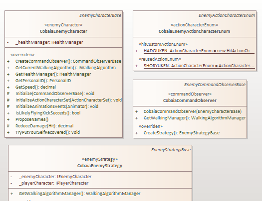

And that is my generated PSM so far:
I wanna all of actionCharacterSetAttribute attribute in Cobaia source class be generate in my CobaiaEnemyCharacter.InitializeActionCharacterSet operation. This way, I intent to initialize an internal cache with those attributes.

Hi, Eve. I'd already tried that. It doesn't work, because the result is the rendering of attributes of CobaiaEnemyCharacter (the PSM renegated). Actually, I wanna get punch-animation and walk-animation attributes of Cobaia PIM class.
