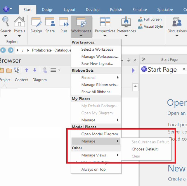

But I thanked you too soon!  *My* version of EA doesn't have the menu path you show.
Struggling to work out how to show you what my interface looks like, but I suspect you are using v15?

« Reply #5 on: October 30, 2020, 11:30:27 pm »
In pre-v15 versions you need to create a new diagram, set it as the model default, and then delete that diagram.
Use F1(help) to find the location of the menu option in your version.

« Reply #6 on: October 31, 2020, 12:38:57 am »
10 points to Geert!
I found and executed the command (Set Model Default) by typing 'Default' in the Find Command... box on the ribbon.  Is there a way of finding out where the command lives, once you have identified its existence via Find Command...?
Search the manual for that string.
