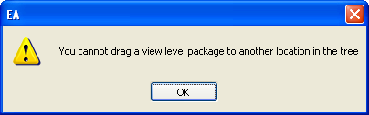

"you cannot drag a view level package to another location"
why not?

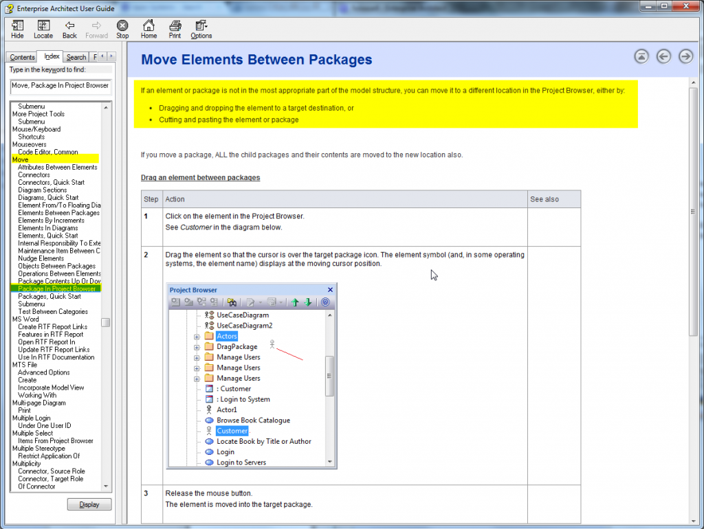

(and yes I searched the help)

In the Project Browser the drag operation changes a Package's LEVEL in the model. You drag a Package into whichever other Package you want it to be a child of, whether that Parent is deeper into the model or at a higher level. To change the sequence of peer Packages, use the green up and down arrows in the Project Browser toolbar.
The root node, View and 'model from pattern' are all designed to be the top-level containers of the project. A root node cannot be contained by anything else; a View can only be contained by a root node (and you can drag a View from one root node into another). For those two, you can re-sequence peer-level nodes and views, but you can't drag one peer into another.
A 'Model from Pattern' takes its behavior from where you initially create it - if you create it under a root node, it becomes a View-level container and cannot be subordinate to anything other than a root node. If you create it under a View or any other Package, it becomes a subordinate structure and can be moved to different levels of the model.

If I decide I don't want a root node to be a root node any more,
or if I decide to move a view from one root node to another I can't
(see error message shown in previous post).
But I can if I export and import,
so why not make it easy to do within the tool?

But I can't drag a view level package to another location in the tree,
why not?
