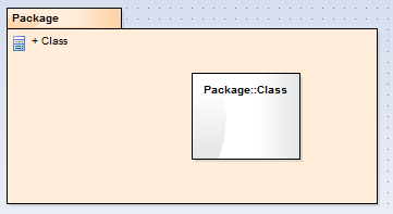

Here is what I did, is this what you are saying?
I LMB click on the foreground object (see diagram above), and hold the mouse button down. [no selection highlighting appears around the foreground object]
I press and hold down the shift key. [the object remains un-highlighted].
I drag using the mouse [the foreground object is highlighted as soon as it starts to move], the foreground object then will move without constraint.
I also tried this
I LMB click on foreground object to select it
I press and hold shift key.
I LMB click, hold, and drag using LMB button on foreground object
The underlying object then moves in a constrained fashion.

A quick reponse from Sparx, thanks
It is not possible to select and shift drag an object when it has a
background object all round it.
Please fix this.
We were able to reproduce this behaviour and have logged it as a bug to be fixed.
Reference Number: 11091224
Effectively it seems the problem is that embedded elements cannot be selected via shift+click.  This also causes problems if you are wanting to select multiple elements via shift+click.  As a workaround in both cases you could consider making the background element not selectable (using the right click "Selectable" option).
Feature request: allow shift key to be selected after drag, causing
object(s) being moved to move either vertically or horizontally only
I will submit a feature request on your behalf so that this is considered for implementation in a future release.

Quote
There is an easier workaround for selecting multiple embedded elements, just hold the ctrl-key and click to select the elements.

Quote
As far as I can see v11 no change
Pressing shift and the dragging only works in the vertical plane.
Feature request was to have this work in the horizontal plane as well, the first movement of the mouse indicating what plane the constraint is in.
Where an entity is in front of another entity it is as confusing as ever.
Selecting the foreground object, then pressing shift, and then dragging drags the background object, talk about a side effect. (Bug)
