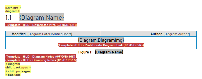

A model document uses a template that places a caption below the diagram.

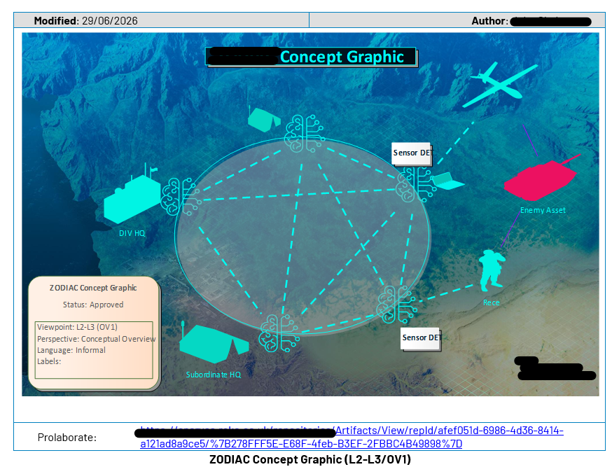

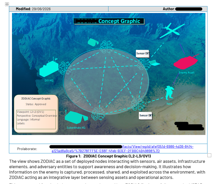

When I export *only* this model document, I get an output like this (some parts redacted)
But... when I export the entire model document (so, multiple individual model documents, using the same template), I get this output...
Note how the Figure 1 prefix has vanished?

If it persists, could you share a minimal template that reproduces it and the output format you’re generating (DOCX, RTF or PDF)? That would help us compare the setups more closely.
